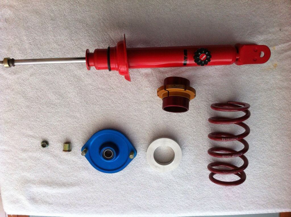

First these are the parts I'm assembling:

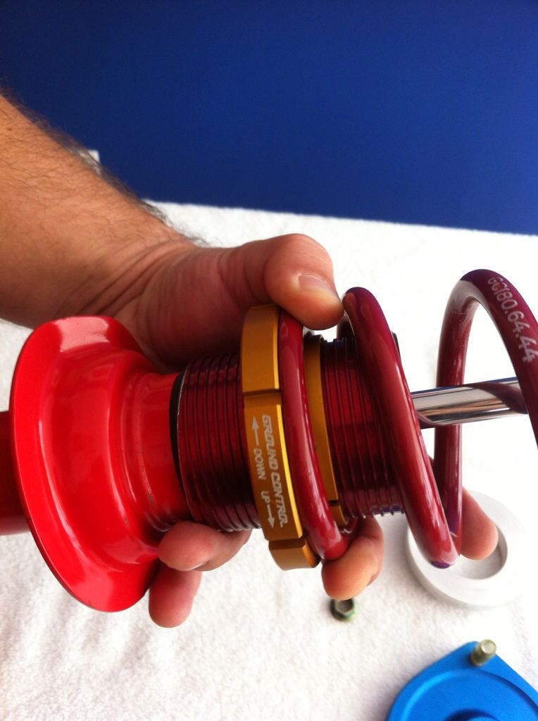

Now comes the sleeve and adjustment perch, the angled side should be installed facing downwards, and by doing so, it actually pinches the o-ring, and doesn't fit flush, do I have to grind anything to make it go all the way down?

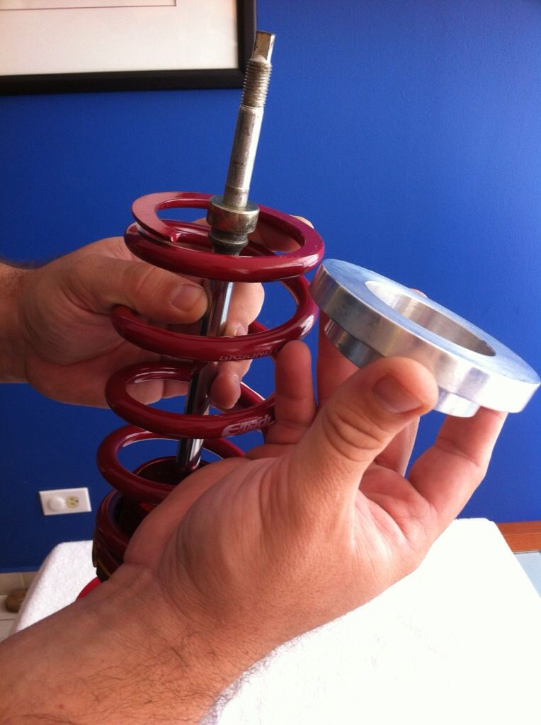

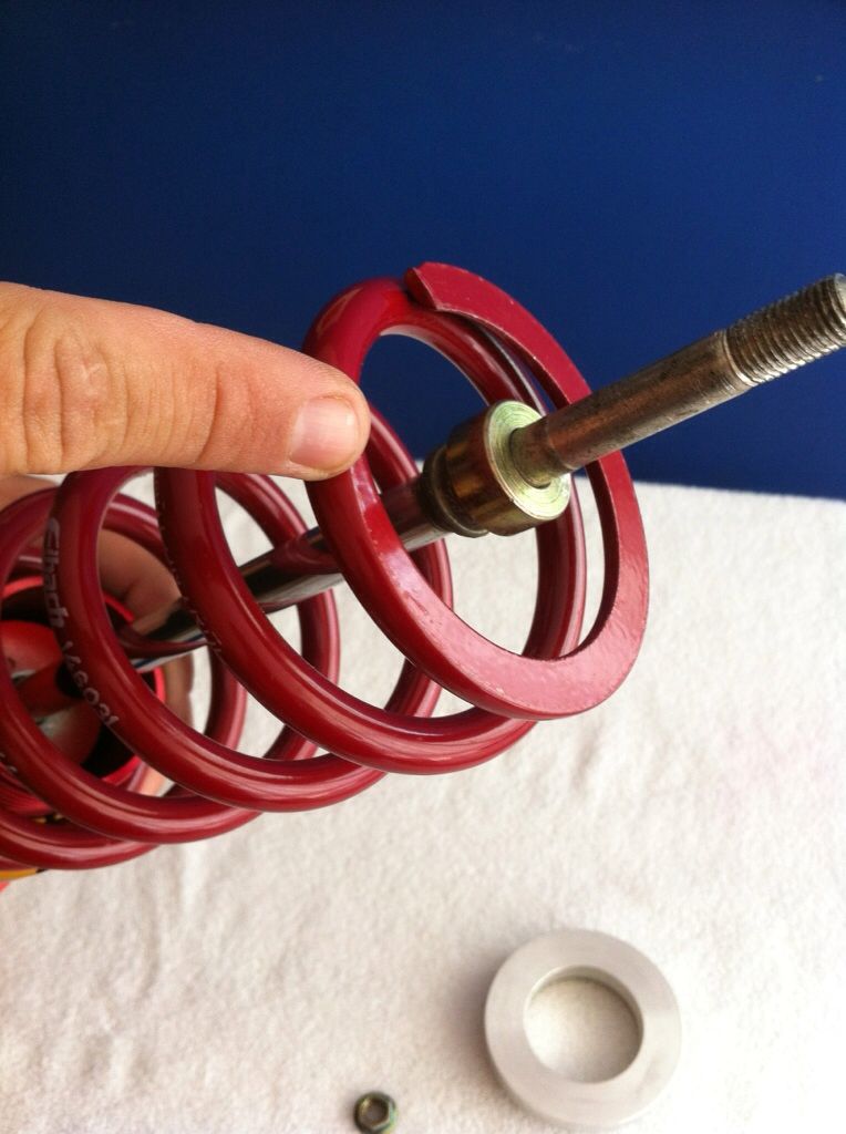

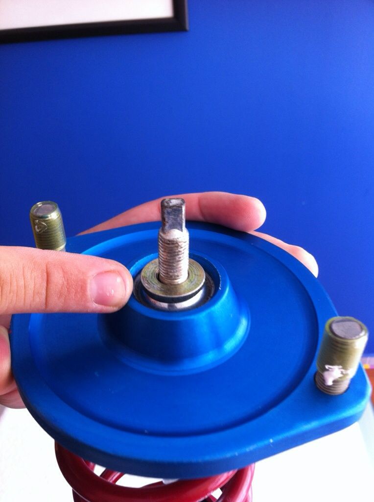

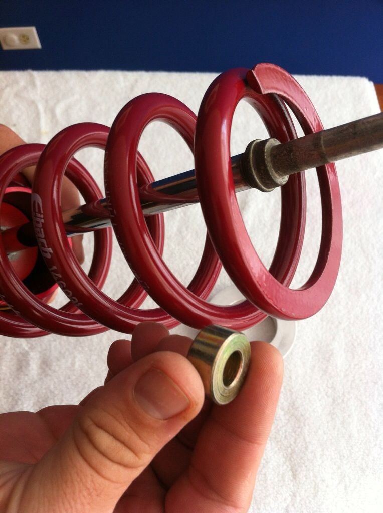

Now the spring, a solid bushing that goes in the shock shaft, aluminum solid mount,  pillow ball mount, another solid bushing that centralizes the shock shaft in the pillow ball mount and nut:
Photobucket Pictures, Images and Photos
Since I'm not using the stock rubber mounts, do I still have to cut/modify /install the stock rubber bump stops? I'm I installing something incorrectly? This is a really important part of our cars and I don't wanna mess anything up.
